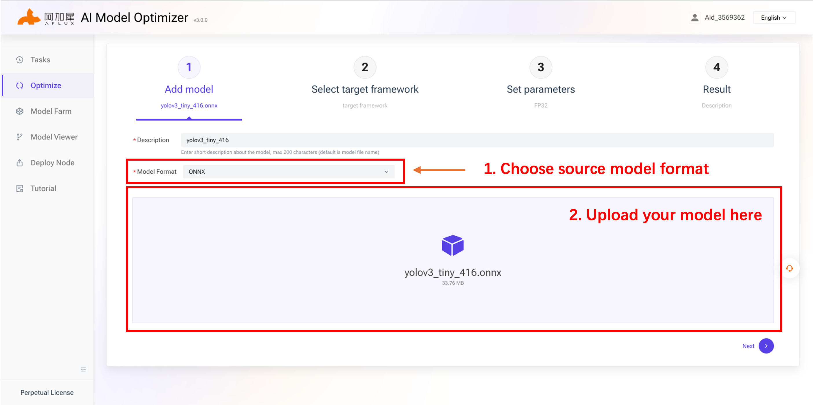

Step 1: Upload Model
First, select the source model format, then drag and drop or click to upload the model to AIMO.
After a successful upload, the page will appear as shown below. The Description field will be auto-filled based on the model filename, and developers can manually edit it.

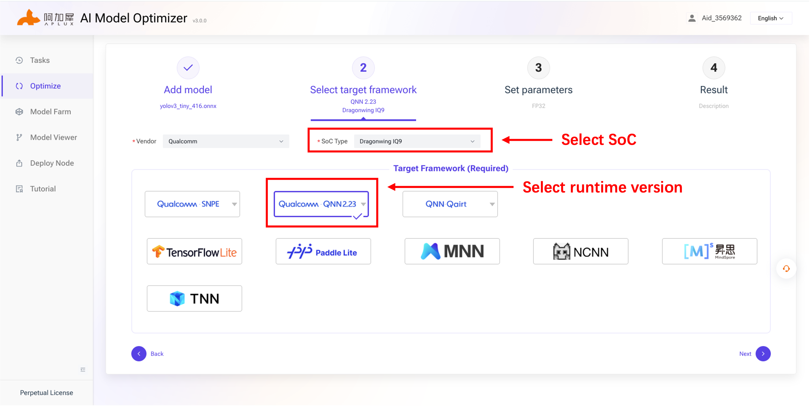

Step 2: Select Target Platform
In this step, select the target platform. When the developer selects an option from the Hardware Platform, the Chip Model section on the right will display the supported models, as shown below:
💡Note
The Chip Model is optional. If a specific hardware model is provided, AIMO can perform better hardware-specific optimization.

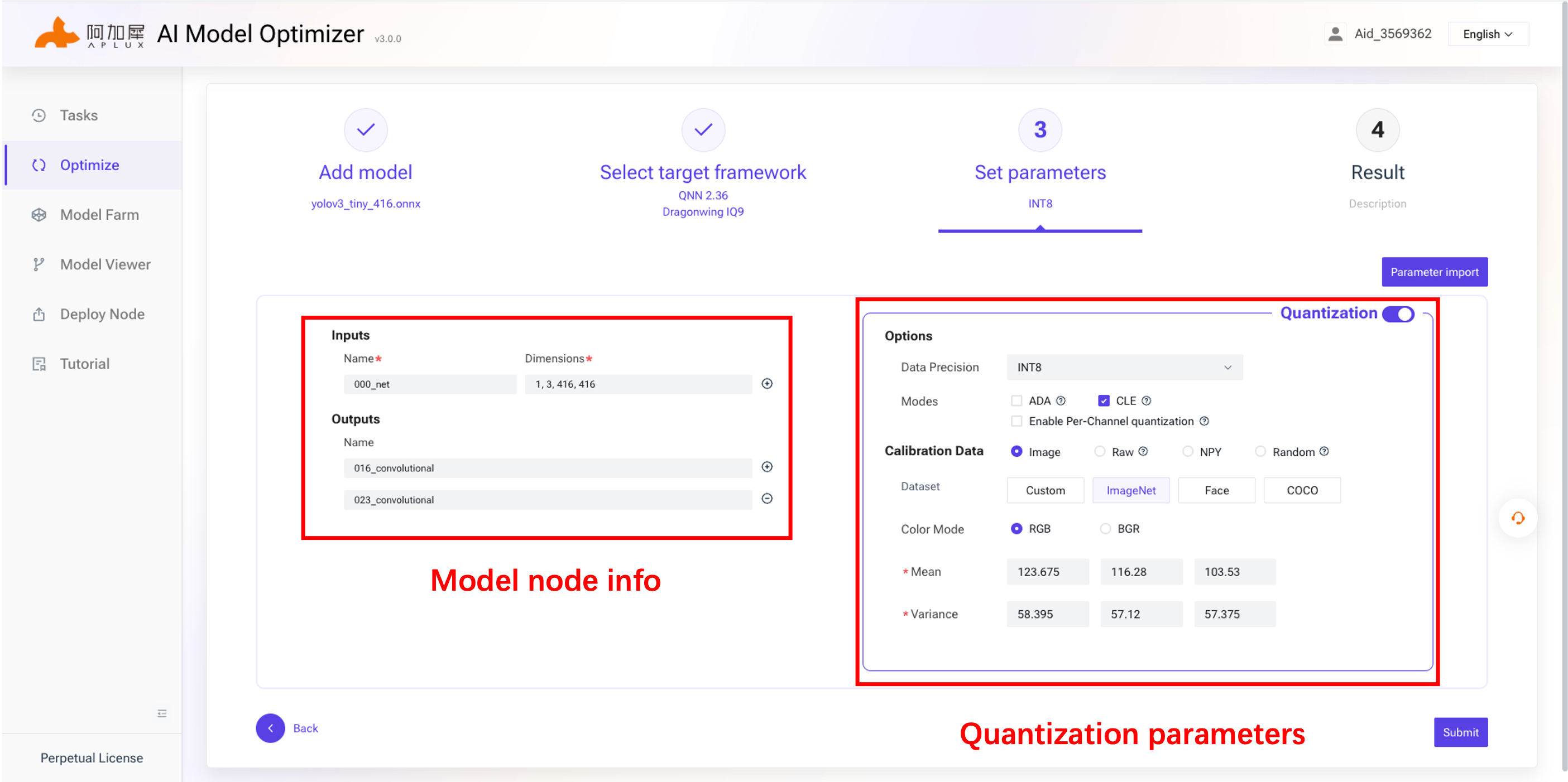

Step 3: Set Parameters
Based on the source model format, the optimization interface may include the following options:
  • Network Simplifying: Simplifies the source model structure into ONNX format. This option appears only when the source model is ONNX.
  • Auto Cut Off: Automatically truncates the model based on the network type, applicable to models with fixed truncation patterns.
  • Auto Quantization: Currently available for some source model formats only.
  • Customize Mode: For advanced custom optimization settings.
💡Note
AIMO performs automatic quantization optimization based on its quantization strategy. This is the recommended method by AIMO and is suitable for beginners.

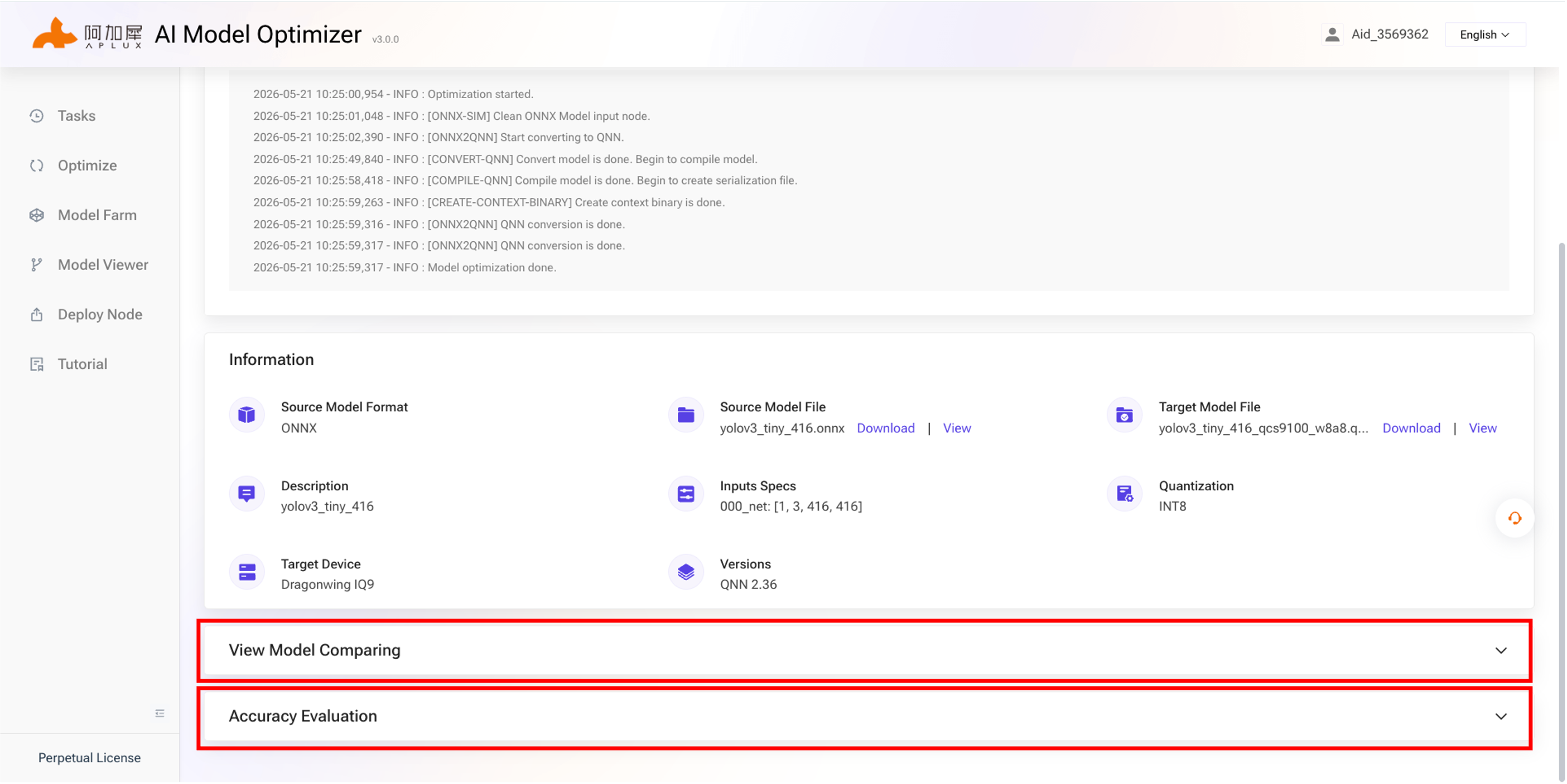

Step 4: Download Model
Once the model optimization completed, user can download the optimized model.
The optimization and conversion time may vary—from just a few seconds to several days—depending on the chosen quantization and optimization settings.
Conversion Failed
If the conversion fails, the Process Log will show detailed error messages. Developers can refer to these logs to identify the cause of the failure.
Developers can refer to the FAQ to help diagnose the issue.
