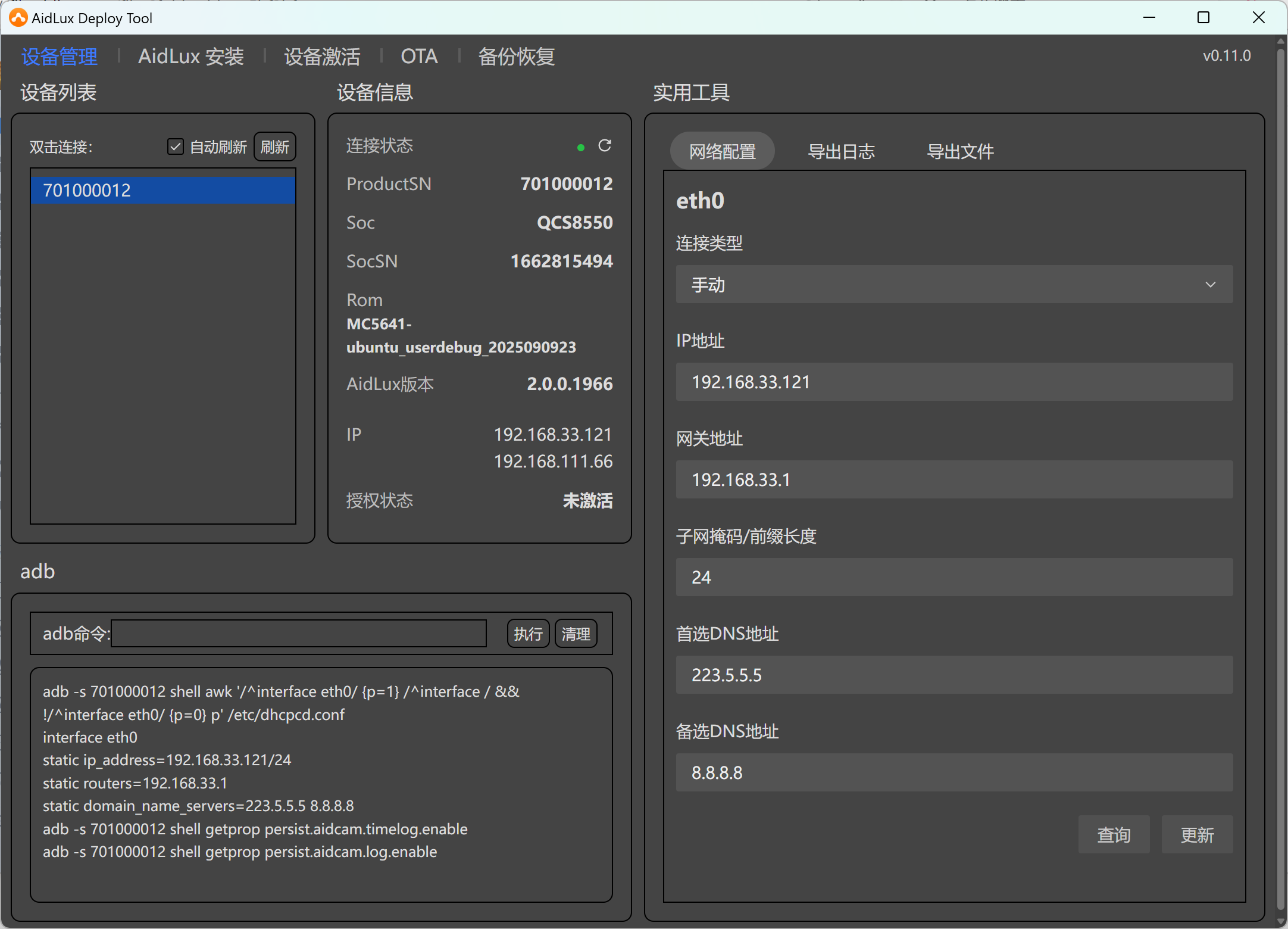

The aid-deploy-tool is a desktop tool installed on Windows computers. After installing the USB driver and ADB tool, and connecting the Windows computer to the AgiX device via a USB Type-A to Type-C cable, you can use this tool to quickly perform convenient operations such as device information reading, IP configuration, AidLux installation, device activation, OTA upgrade, backup and restoration, and log collection.

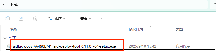

  • Download the tool via the software download link, then double-click the exe file with the left mouse button to start the installation.

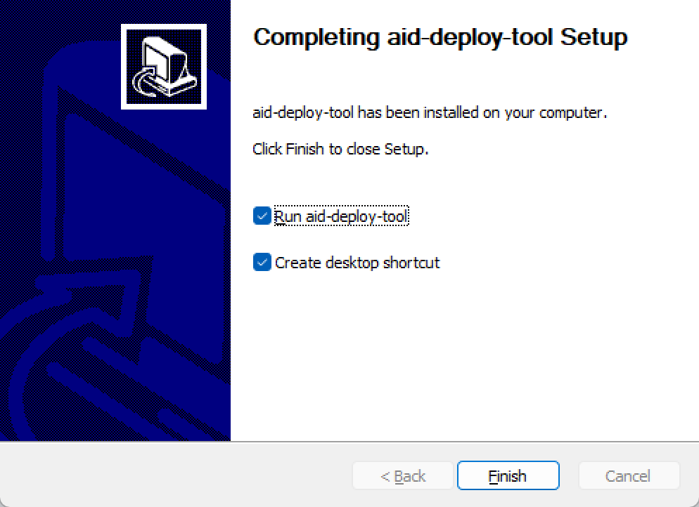

  • In the pop-up installation window, follow the prompts to install. You can click "next" continuously with the default settings.
  • After installation, the tool will open by default.
