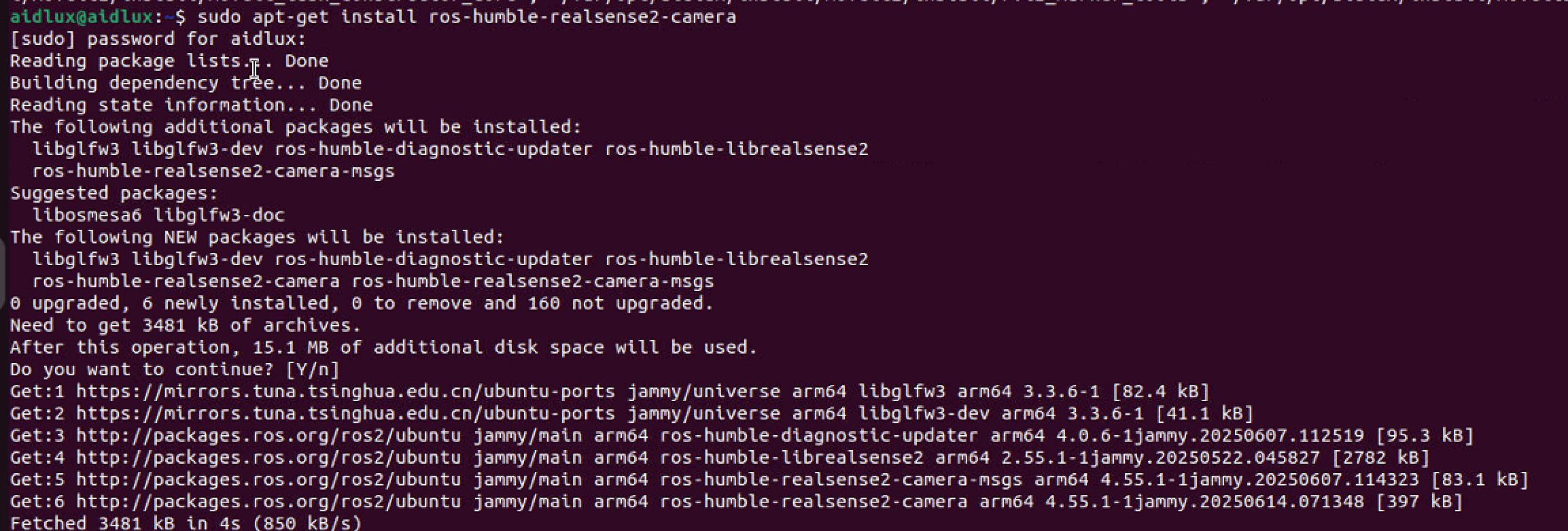

sudo apt-get update
sudo apt-get install ros-humble-realsense2-camera

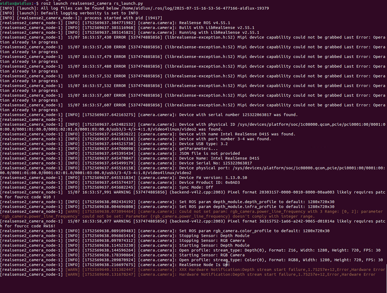

  1. After successful connection, launch the camera driver using the following command:
ros2 launch realsense2_camera rs_launch.py

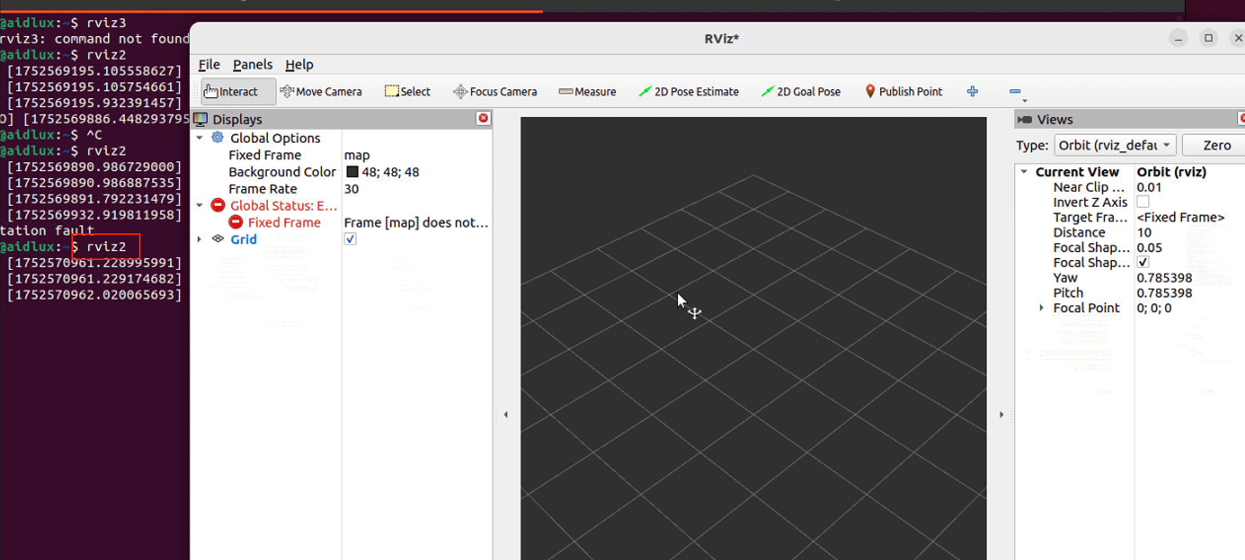

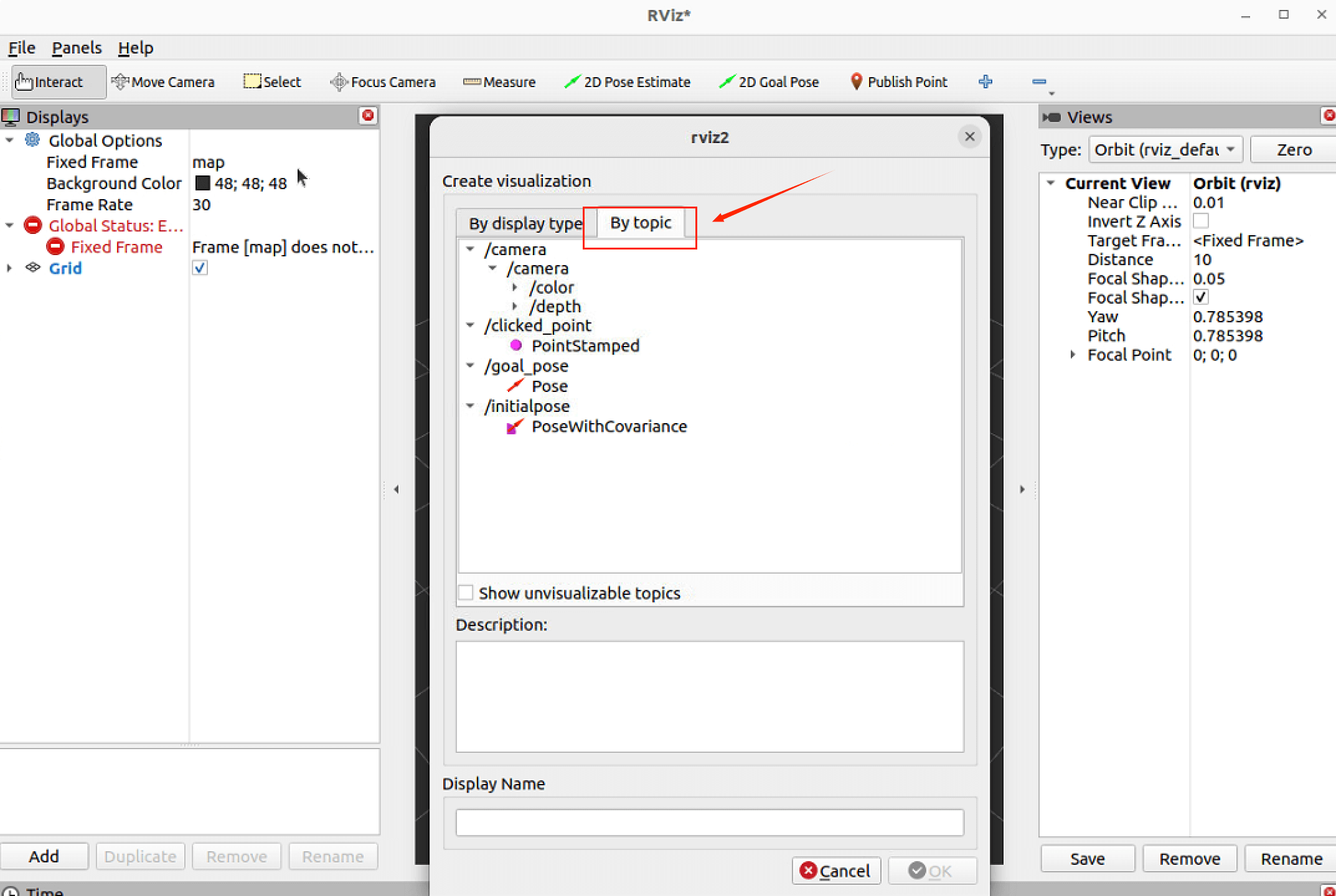

  1. Open RViz2 Open a terminal and enter: rviz2

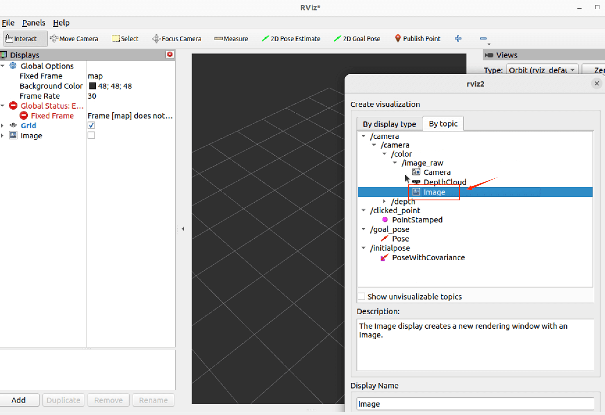

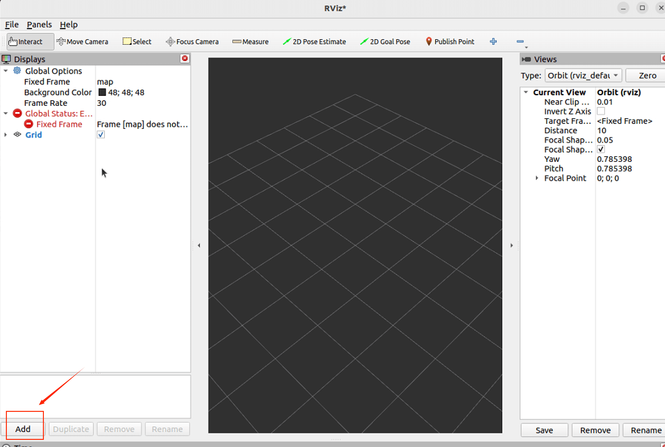

  1. Verify and display the depth camera image in RViz2 Click the Add button in the bottom-left corner.
Click By topic in the pop-up window.

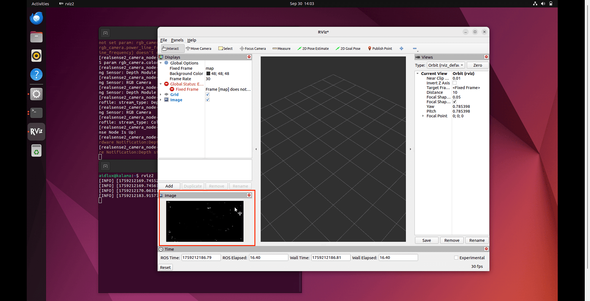

Double-click to open image under the /camera node, and observe the camera-captured image appearing in the image pop-up window in the bottom-left corner.
