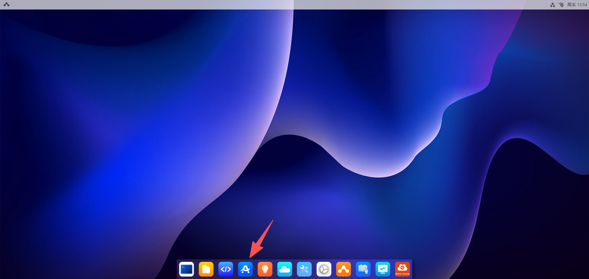

  1. Refer to the Quick Start - System Usage -- Web Login section, and log in to the device's web desktop.

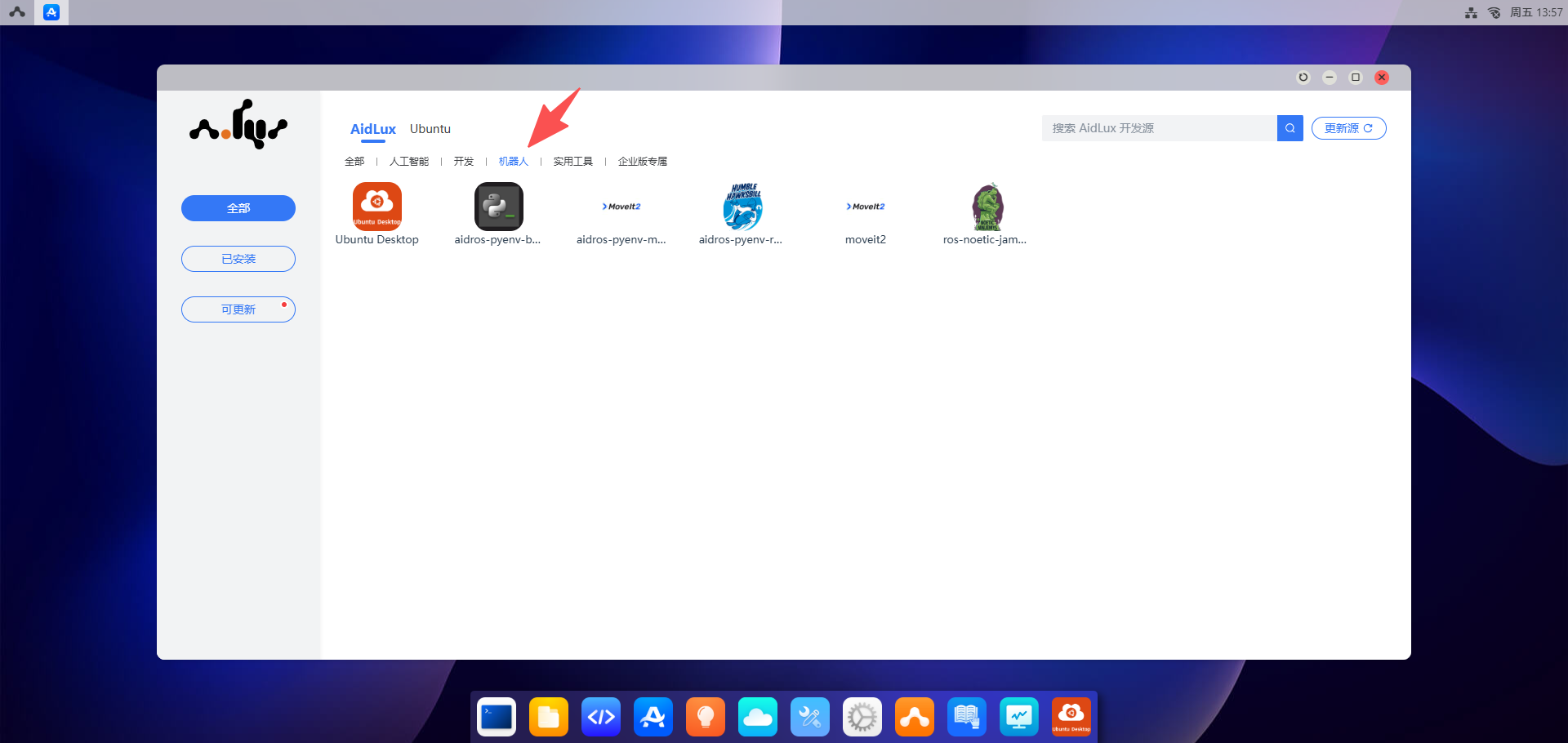

  2. Click the App Center button, then select Robot.

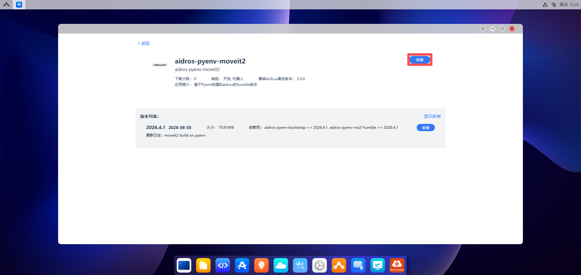

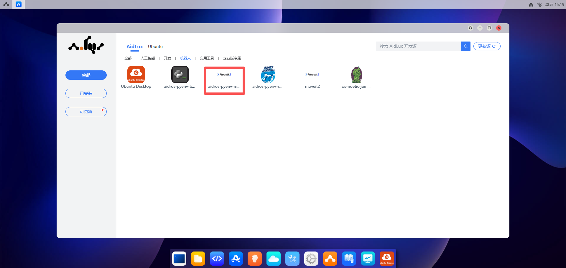

  1. Install "aidros-pyenv-moveit2"
    1. Click aidros-pyenv-bootstrapalt text
    2. Click the Install button, and enter the password: "aidlux" alt text

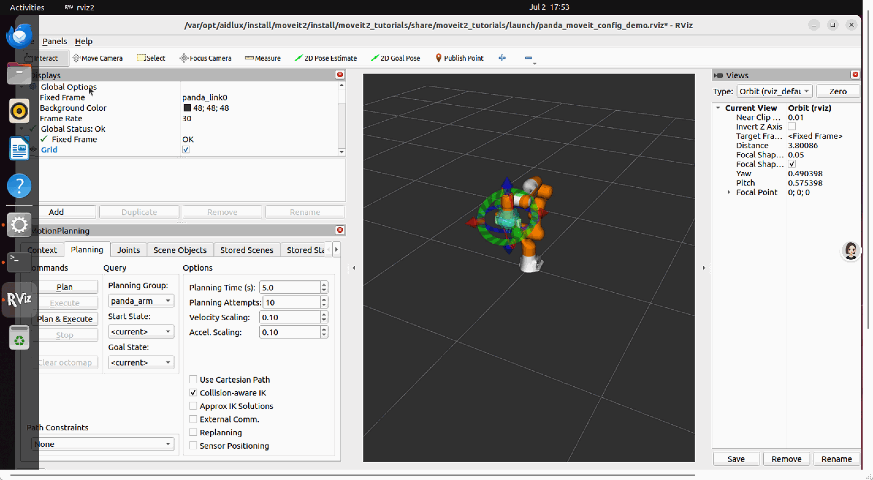

After installing MoveIt2, you can verify whether the installation was successful using the following method.
  • Log in to the Ubuntu Desktop. For remote desktop usage, please refer to Remote Desktop Usage.
  • Open a Terminal window and execute the command: source /opt/ros/humble/setup.bash to initialize system resources.
  • Open a Terminal window and execute the command: ros2 launch moveit_resources_panda_moveit_config demo.launch.py. In the pop-up rviz window, you can move the robotic arm.
