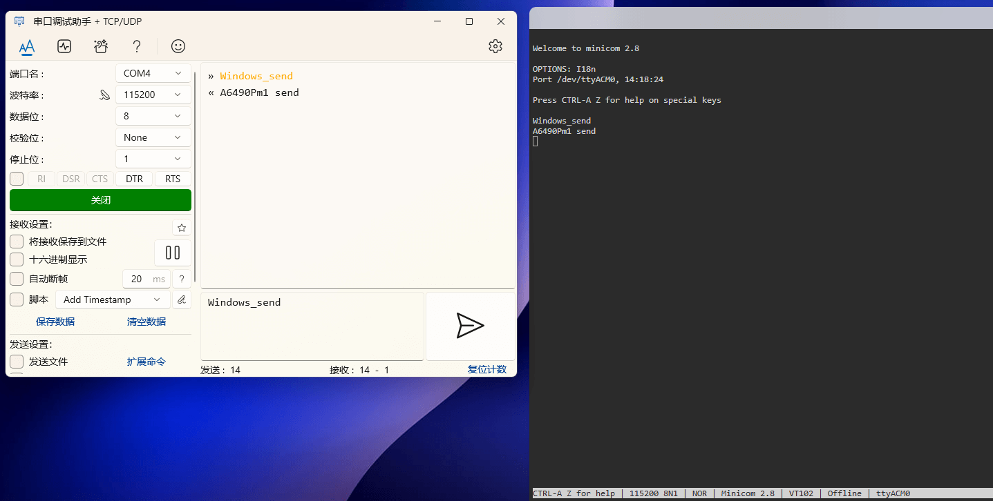

Testing
After completing the connections, open the minicom tool in the AidLux terminal (install it first if not present using the command: sudo apt update;sudo apt install minicom).
sudo apt install minicomOnce installed, open the serial port:
sudo minicom -D /dev/ttyUSB0 -b 921600 -HThe default baud rate of the TOF sensor is 921600, and data needs to be displayed in hexadecimal format.
Note: If minicom only displays a single line of data, configure it as follows: Press CTRL-A Z to enter the minicom settings page, then press W to enable line wrapping for display.
Below is an example of the received data.
