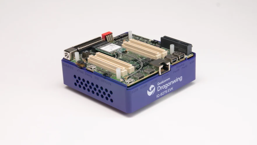

Product Appearance ​
IQ8275 product appearance
