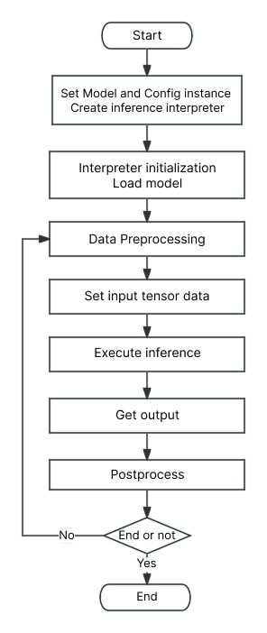

Development Flowchart
Development Workflow Explanation
💡Note
The following code demonstrates the core development flow. For full API details, refer to the AidLite API Documentation.
