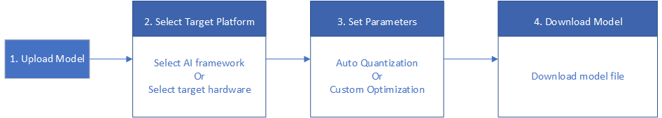

The AIMO workflow is shown in the diagram below:

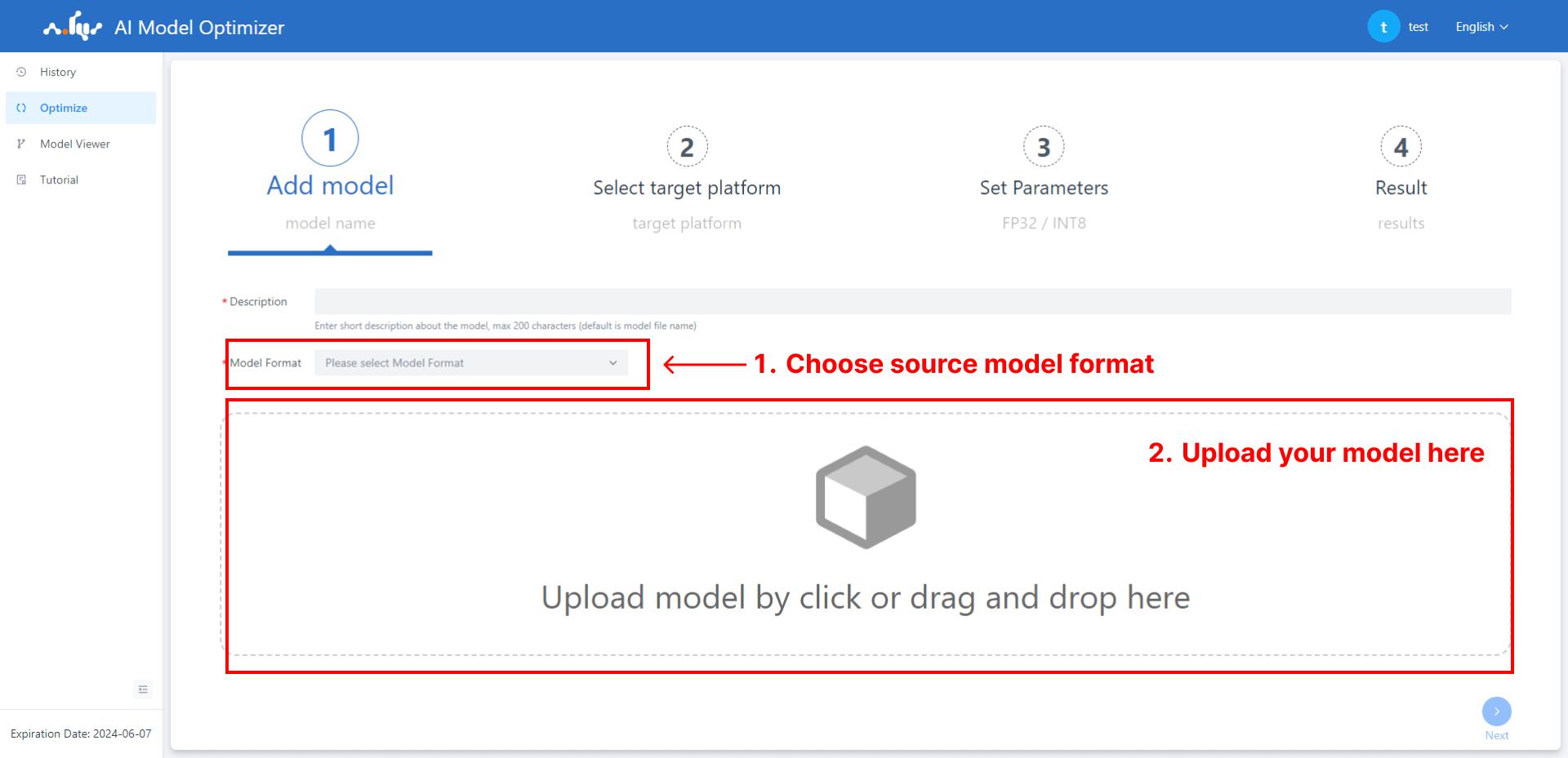

Step 1: Upload Model
First, select the source model format, then drag and drop or click to upload the model to AIMO.

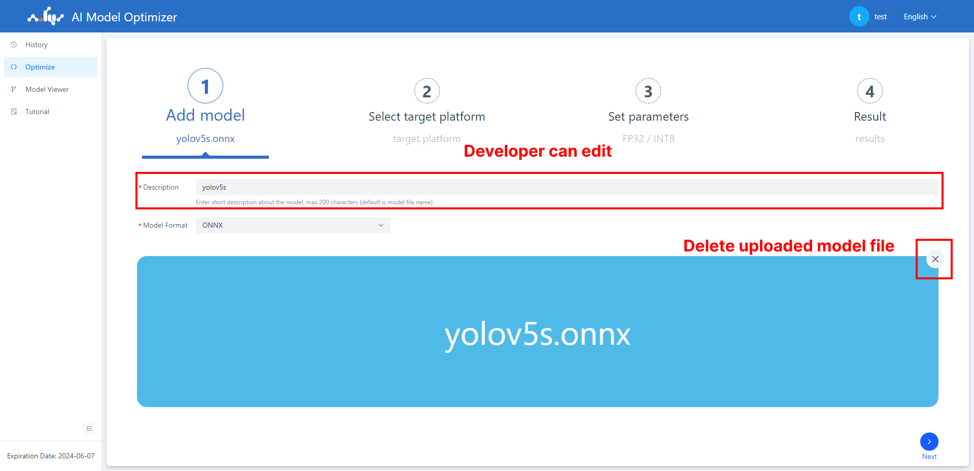

After a successful upload, the page will appear as shown below. The Description field will be auto-filled based on the model filename, and developers can manually edit it.

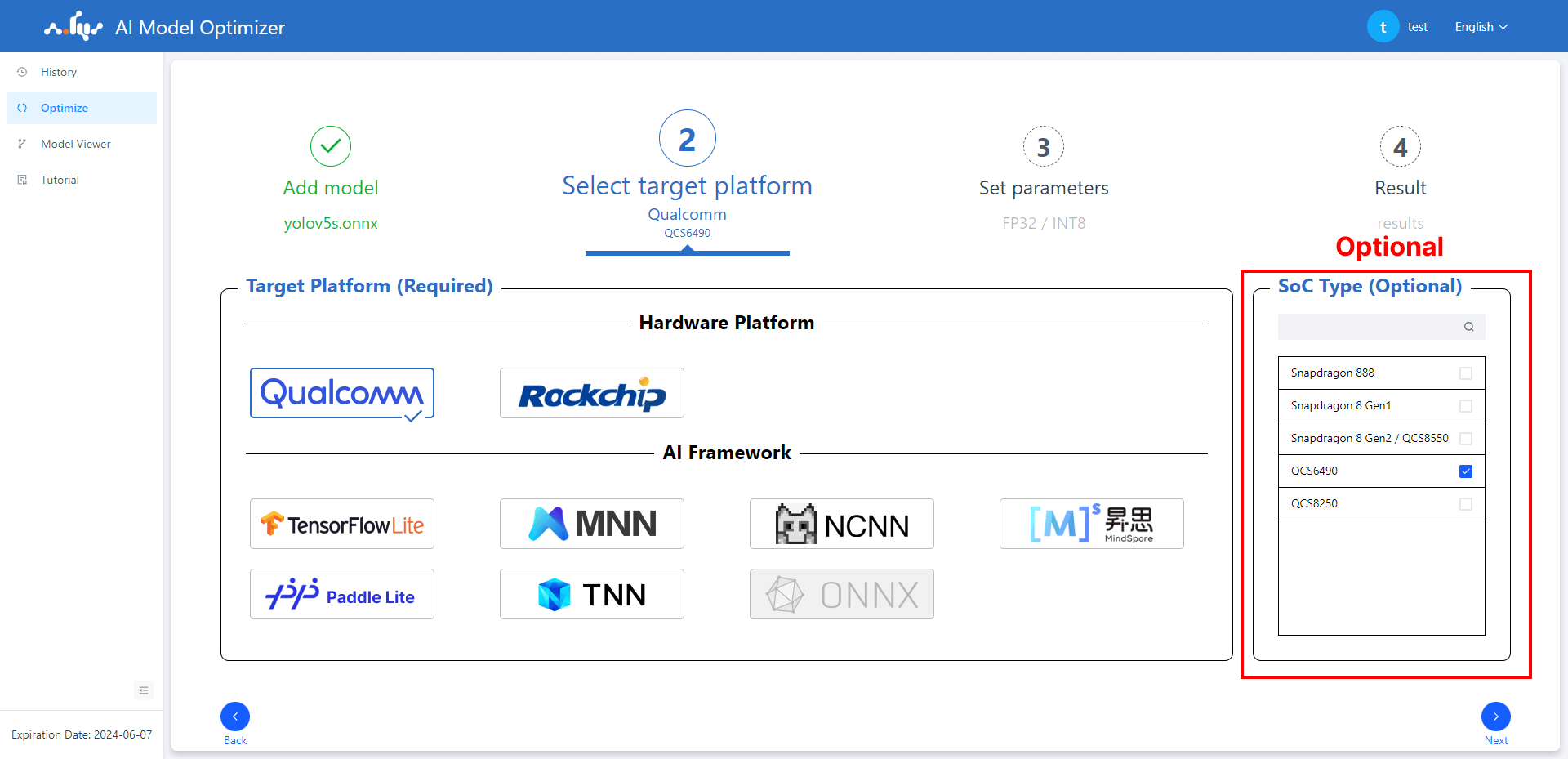

Step 2: Select Target Platform
In this step, select the target platform. When the developer selects an option from the Hardware Platform, the Chip Model section on the right will display the supported models, as shown below:
💡Note
The Chip Model is optional. If a specific hardware model is provided, AIMO can perform better hardware-specific optimization.

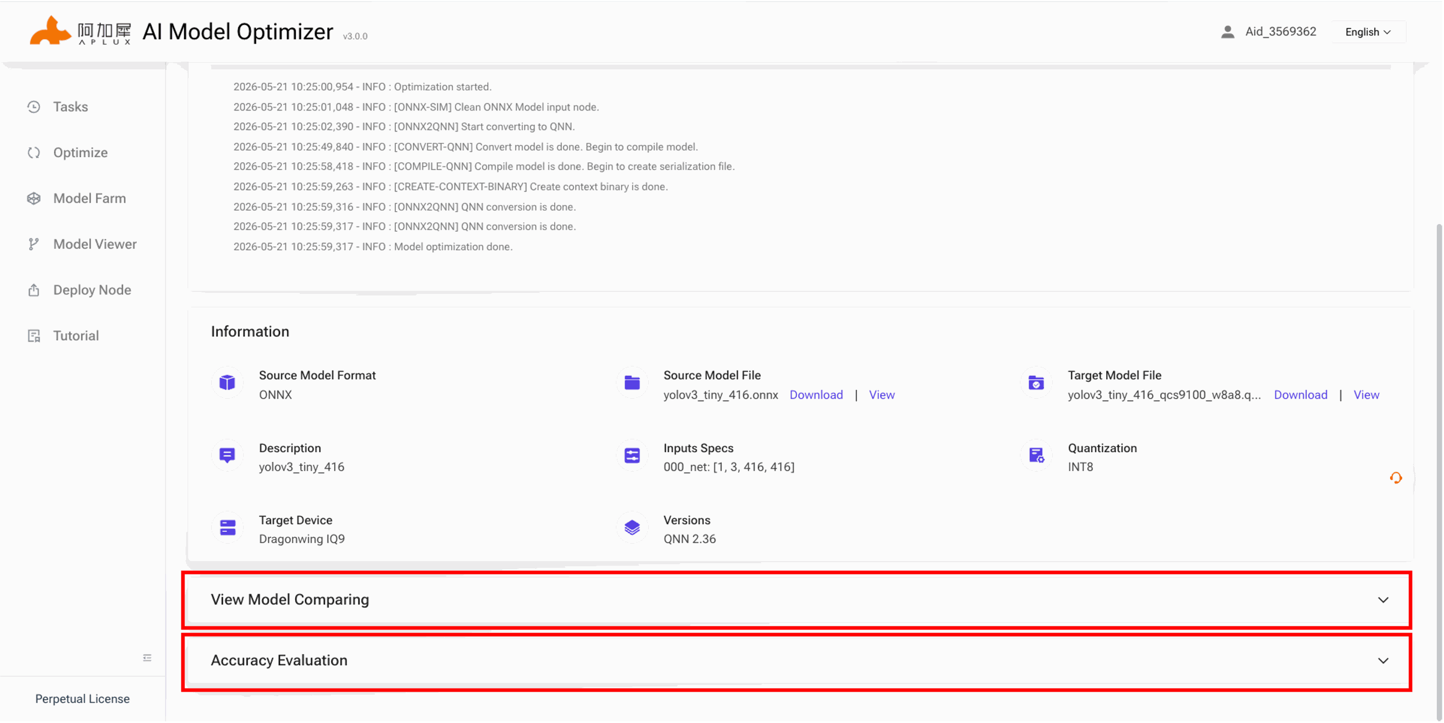

Conversion Failed
If the conversion fails, the Process Log will show detailed error messages. Developers can refer to these logs to identify the cause of the failure.
Developers can refer to the FAQ to help diagnose the issue.

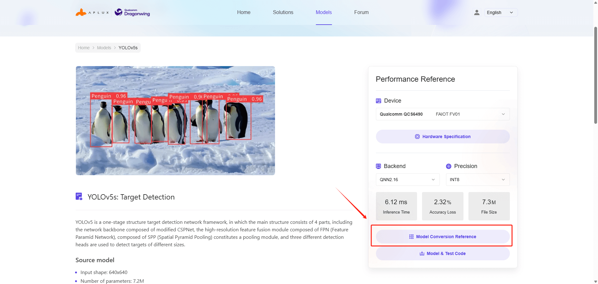

Taking YOLOv5s INT8 as an example:
Visit Model Farm
Log in developer account
Search for YOLOv5s
Enter the model detail page and click the Model Conversion Reference button under the performance section on the right
