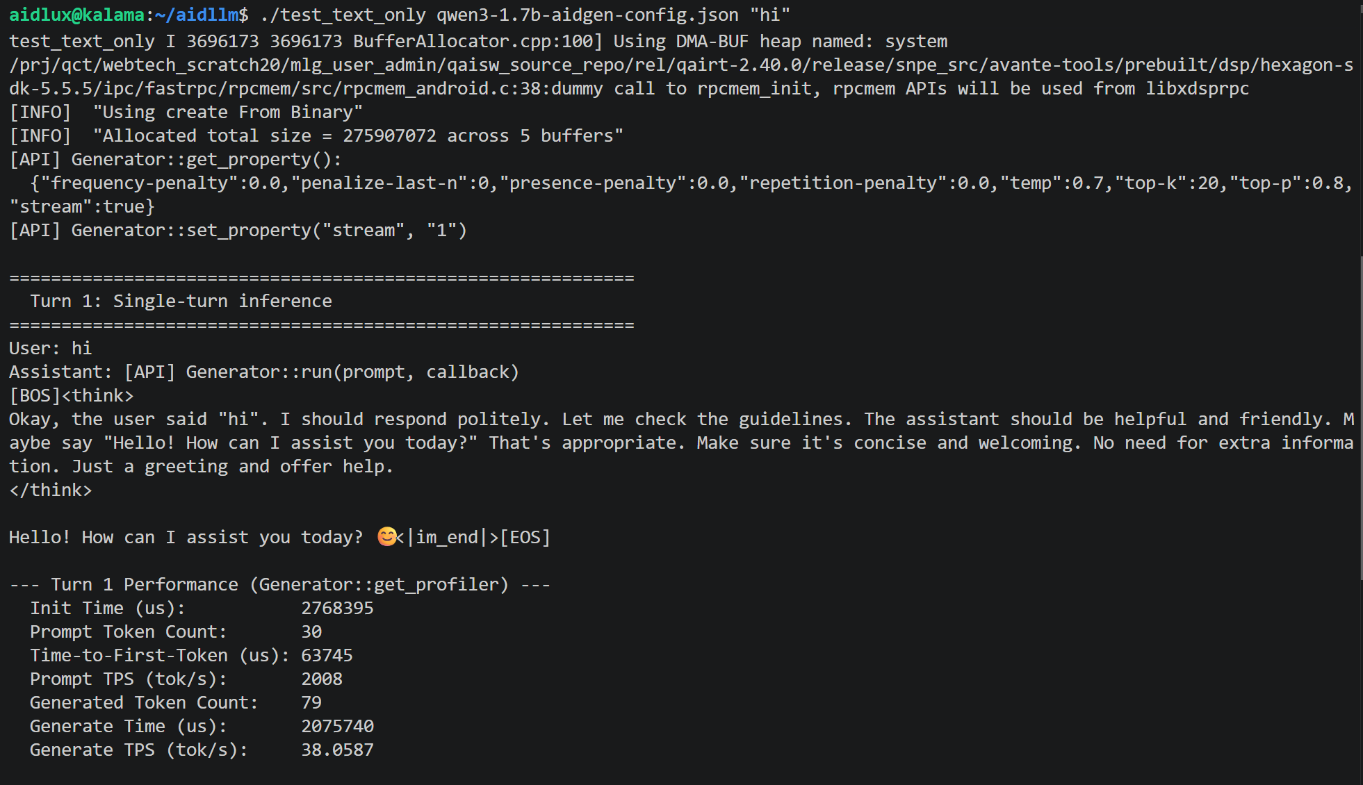

./test_prompt_serial qwen3-1.7b-aidgen-config.json 1 1
  • Enter your text in the terminal to start the conversation.
