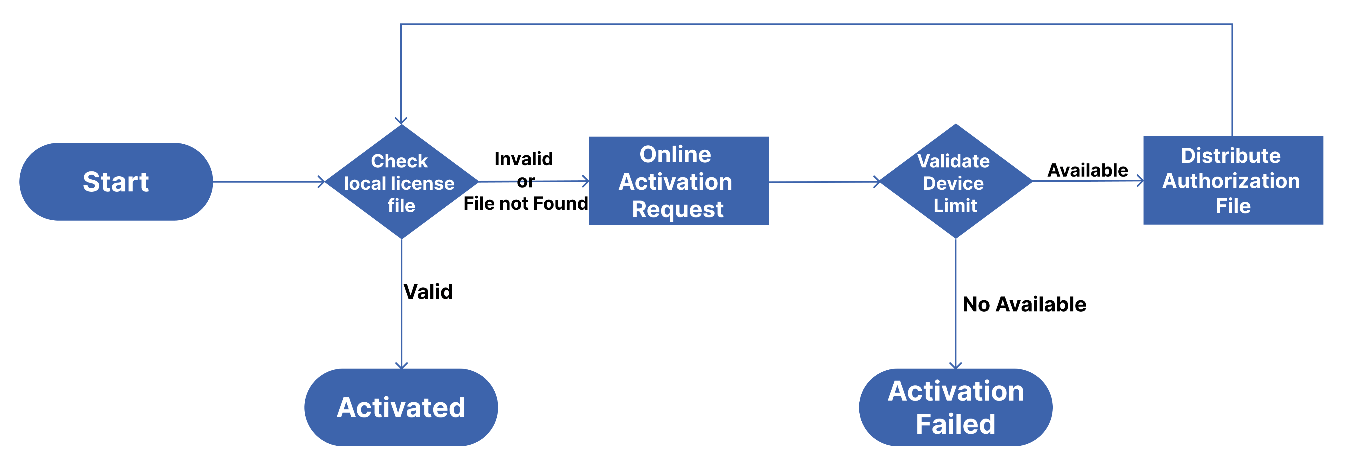

The development kits provided by AidLux can only be used normally in an activated environment. Activation is implemented through the LMS component in the AidLux SDK.
LMS activation uses an online authorization on first use, followed by offline environment verification. The workflow is as follows:
