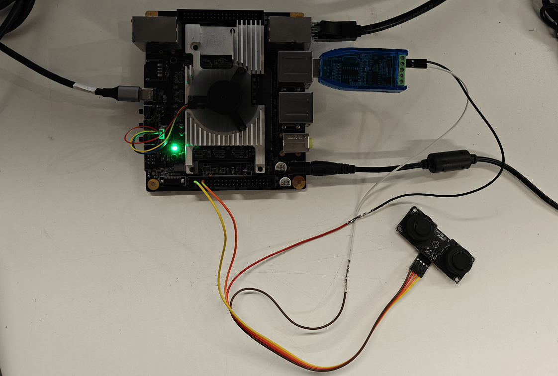

- The sensor requires a minimum 5V power supply: connect the VCC and GND pins of the sensor to PIN2 and PIN6 (Raspberry Pi pin side) of Rhino Pi-X1 respectively.
- Connect the RS485A and RS485B pins of the ultrasonic sensor to the RS485A and RS485B pins of the USB-to-RS485 adapter board for communication.
- Identify the USB-to-RS485 adapter board device:

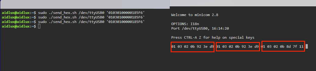

printf "$HEX_DATA" | xxd -r -p > $SERIAL_PORT- Send the control command using the script:
sudo ./send_hex.sh /dev/ttyUSB0 '01030100000185F6'
./send_hex.sh /dev/ttyUSB0 '01030100000185F6'/dev/ttyUSB0: Device number of the USB-to-RS485 adapter board01030100000185F6: Command to read processed value data. For other commands, refer to the DYP product manual.
- Receive data using the minicom tool in AidLux (install it first if not present:
sudo apt update; apt install minicom).
Open minicom: sudo minicom -D /dev/ttyHS1 -b 9600 -H
sudo minicom -D /dev/ttyUSB0 -b 9600 -H/dev/ttyUSB0: Device number of the USB-to-RS485 adapter board-b 9600: Set the baud rate to 9600 (default baud rate of the sensor)-H: Display data in hexadecimal format
