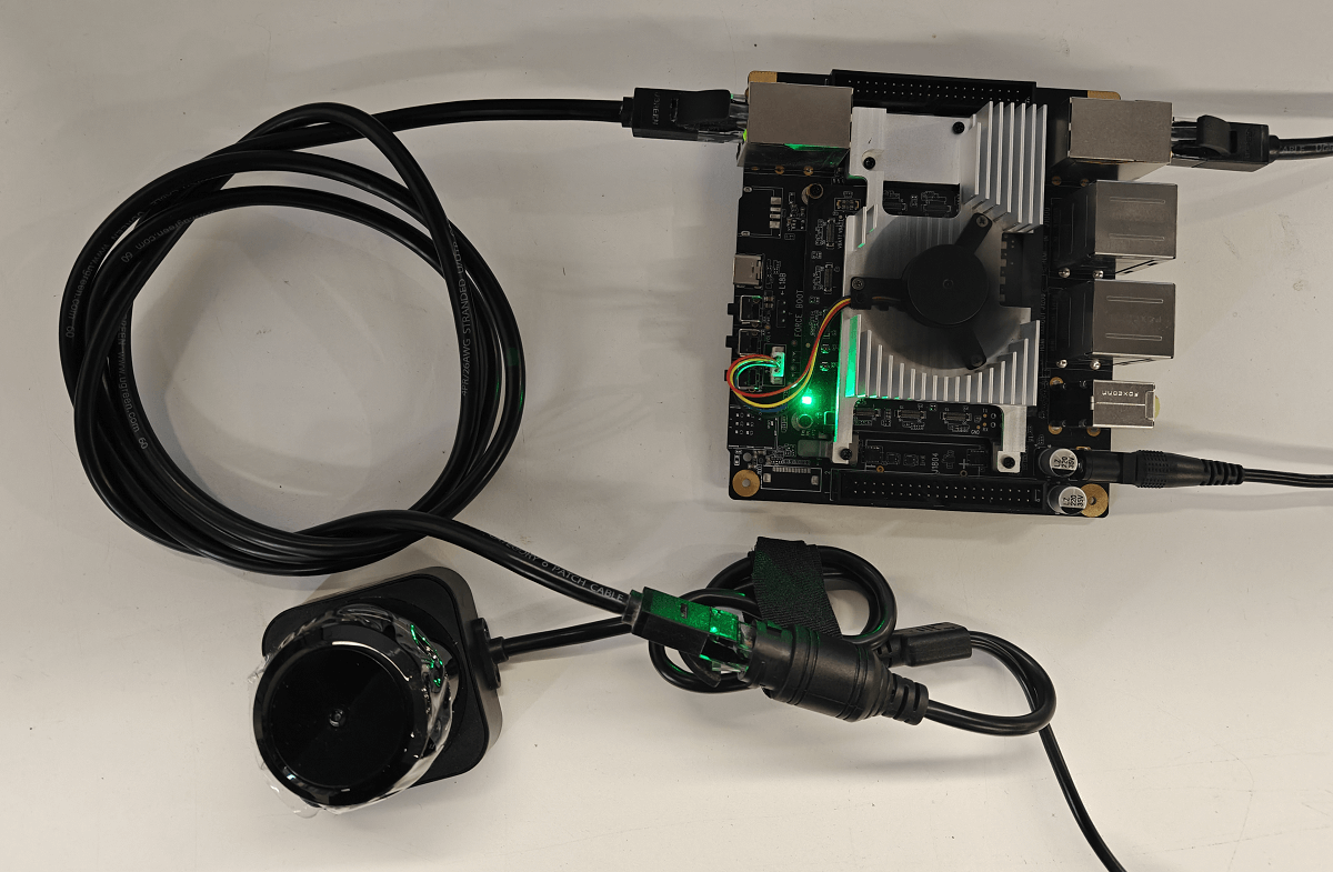

Connect the LiDAR to a 12V power supply, and connect its Ethernet port to any Ethernet port of Rhino Pi-X1. Configure a temporary IP address (you can use the ifconfig command for temporary IP configuration).
The LDS-50C-E and Rhino Pi-X1 are connected via a standard Ethernet interface with a network cable. To ensure normal communication between the LiDAR and Rhino Pi-X1, they must be on the same network segment. The factory settings of the LiDAR are as follows:

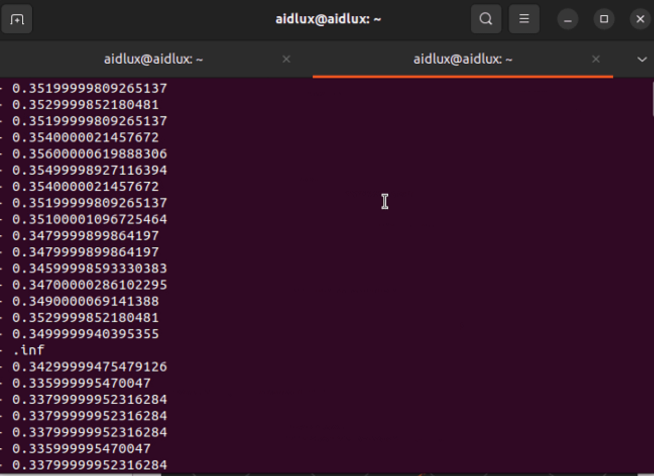

- Data Verification: Check if the scan data is output normally
ros2 topic echo /scan

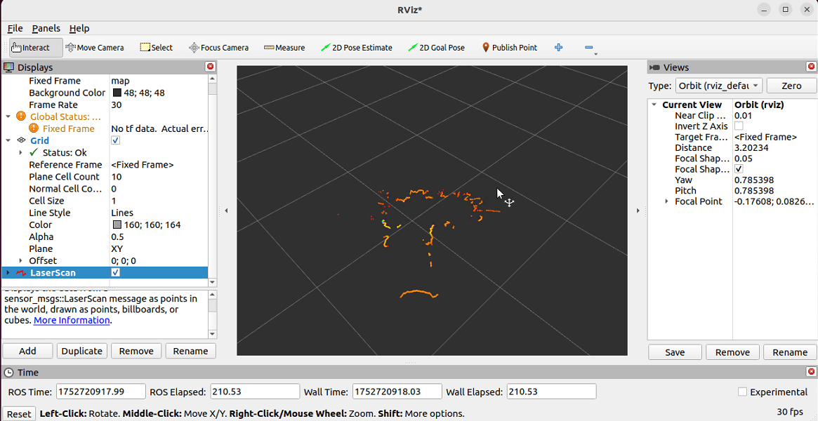

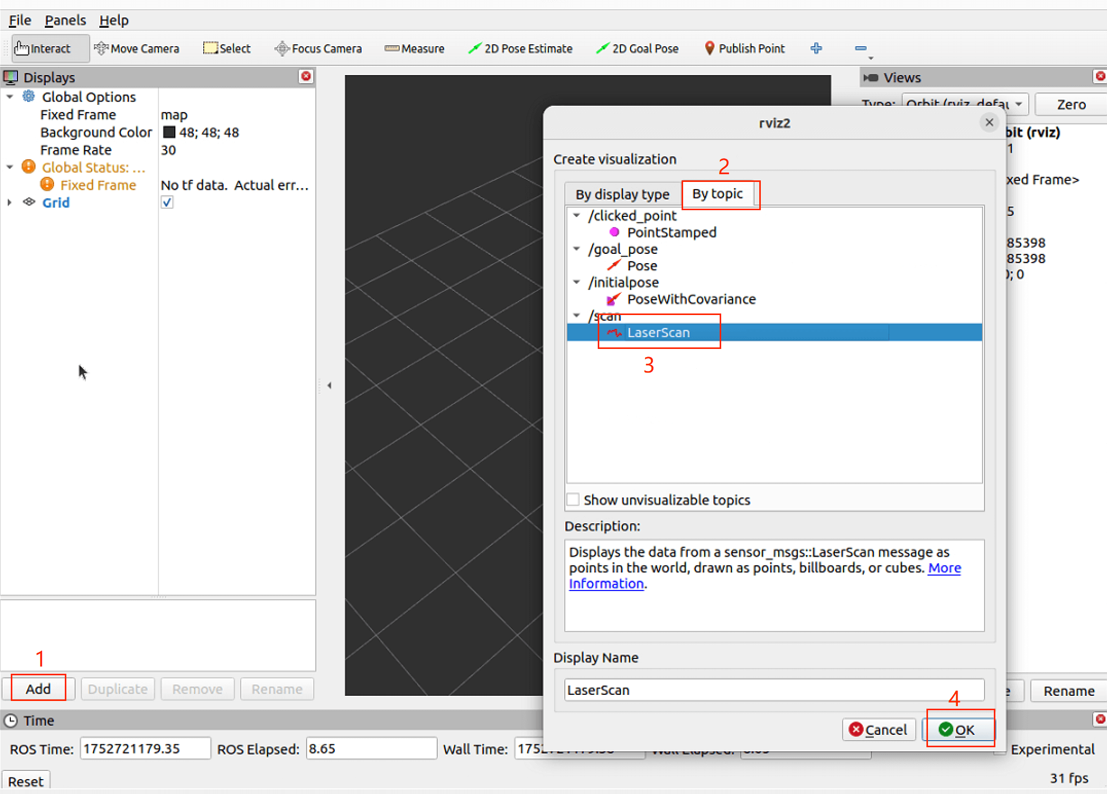

- Open the visualization tool RViz2
rviz2- After opening, click the following buttons in sequence to launch the visualization interface
