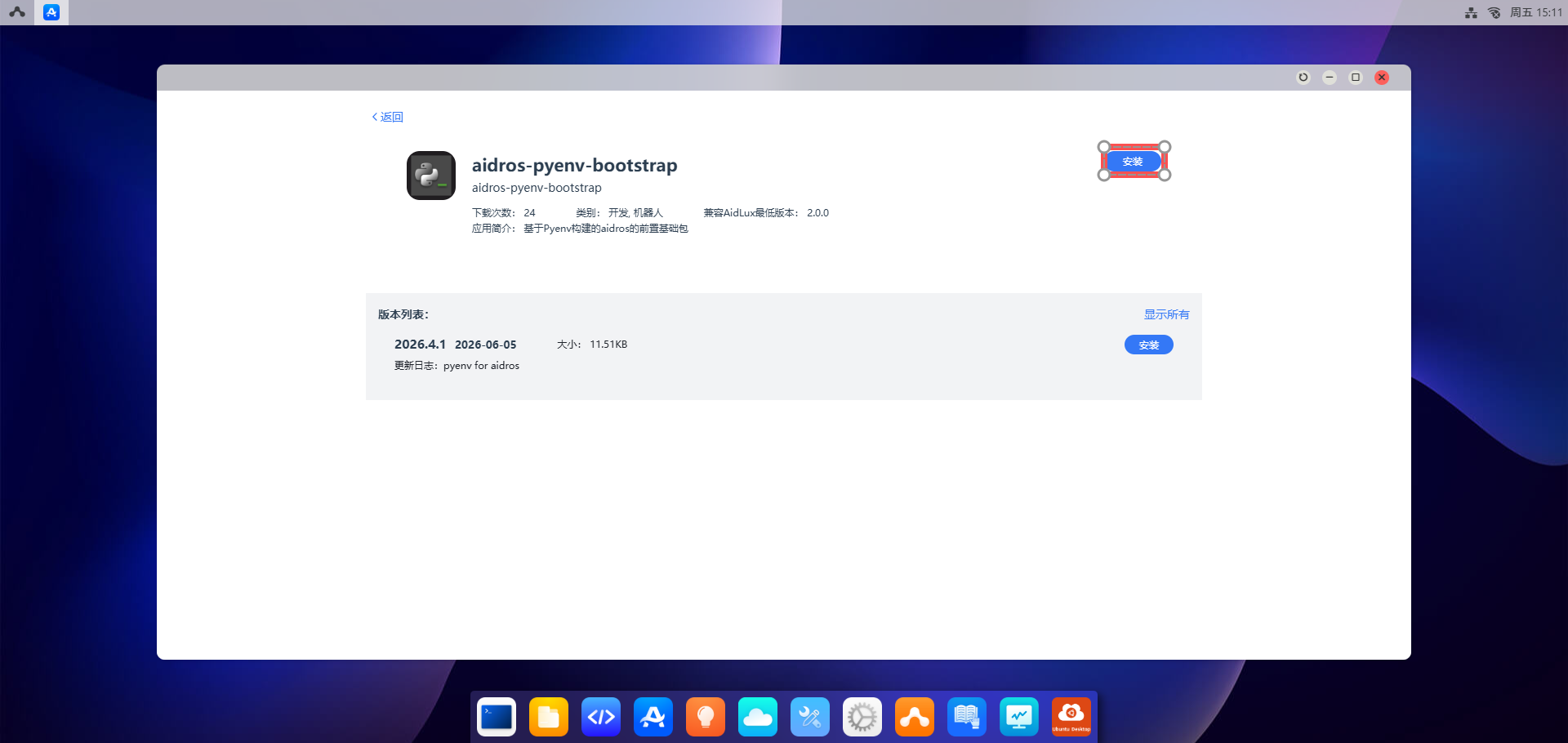

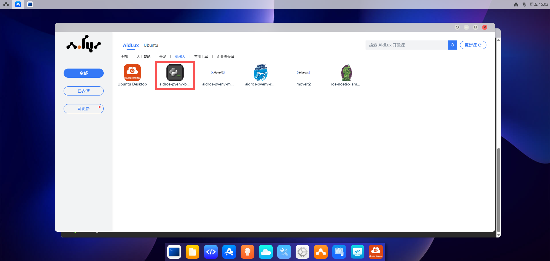

  1. Install "aidros-pyenv-bootstrap"
    1. Click aidros-pyenv-bootstrapalt text
    2. Click the Install button, and enter the password: "aidlux" alt text

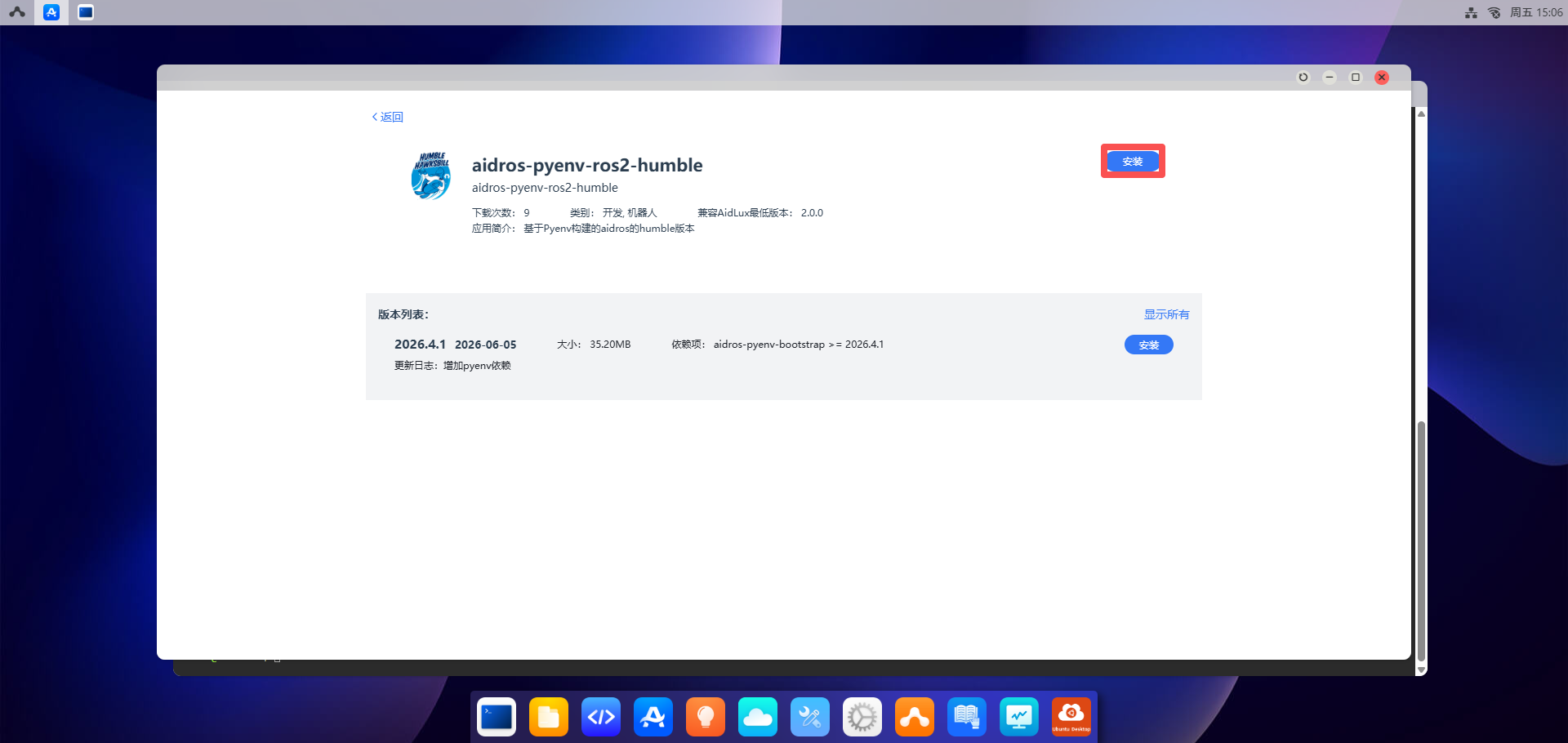

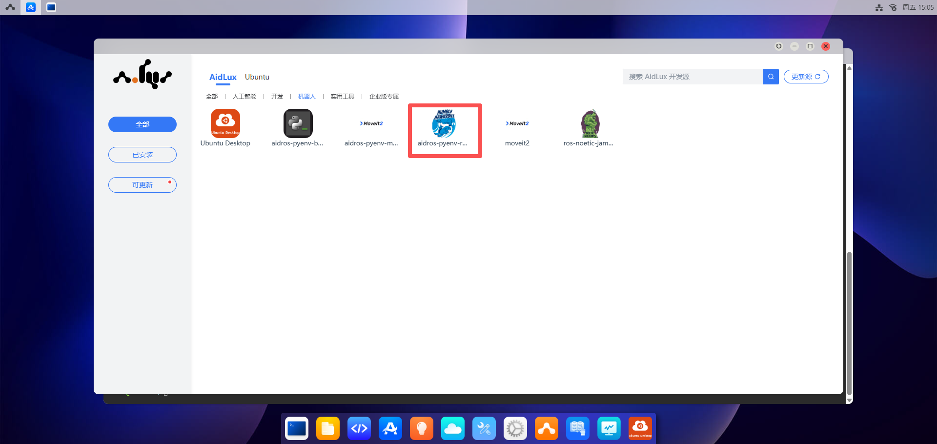

  2. Install "aidros-pyenv-ros2-humble"
    1. Click aidros-pyenv-ros2-humblealt text
