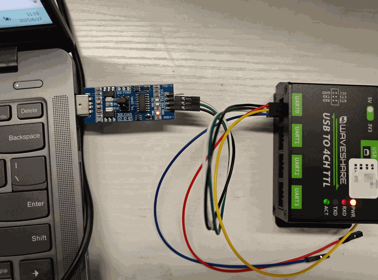

Hardware Connection ​
  • Connect the development board via USB to the CH344 device.
  • Connect the CH340 test board to the Windows PC USB port and the CH344 device.
Connect CH344 RXD/TXD/GND to CH340 TXD/RXD/GND.

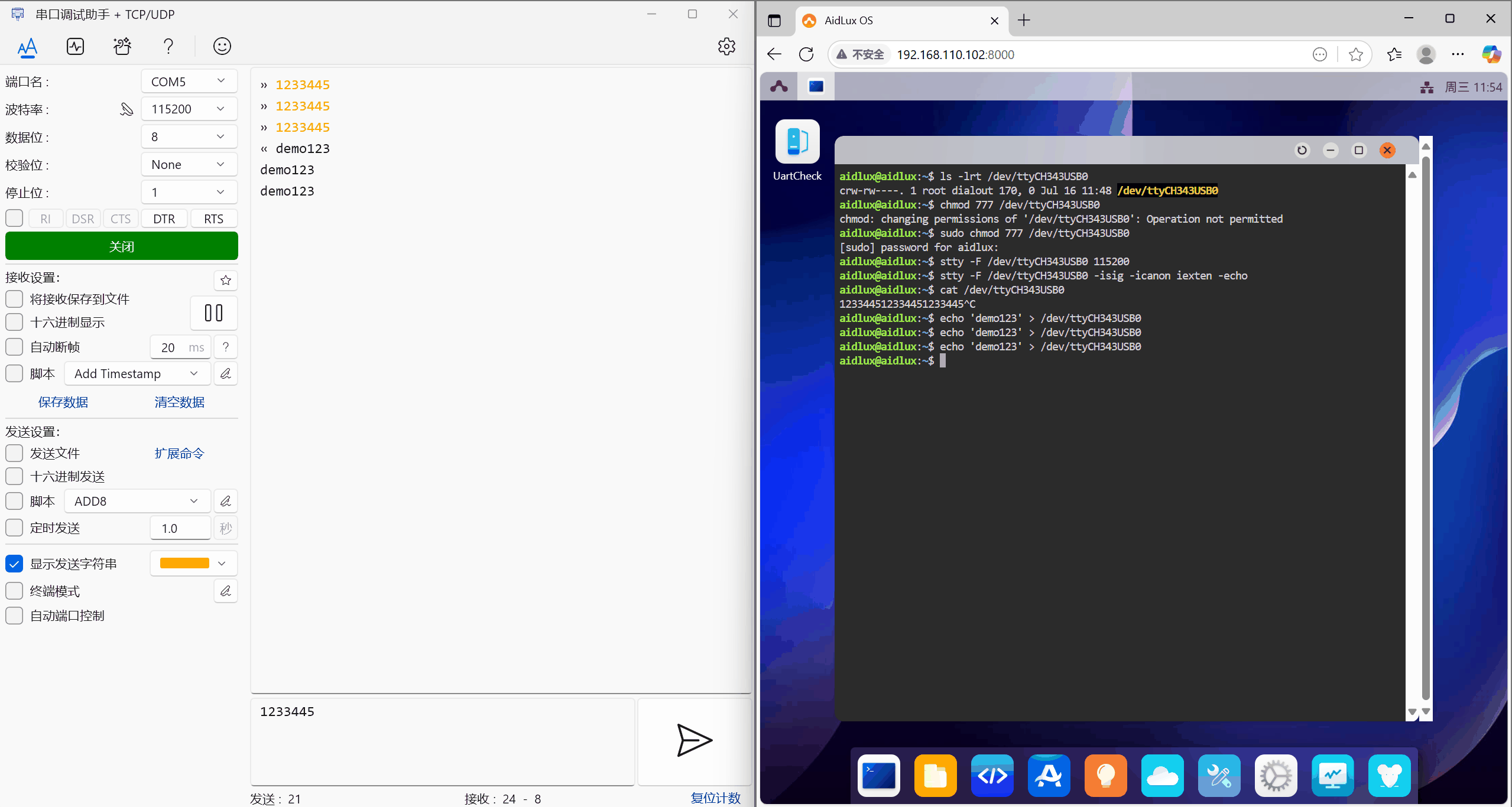

  • Use stty in the AidLux terminal to configure the UART device:
stty -F /dev/ttyCH343USB0 115200   # Set ttyCH343USB0 baud rate to 115200
stty -F /dev/ttyCH343USB0 -isig -icanon iexten -echo
  • On Windows, open a serial terminal tool and open the corresponding port with the same baud rate.
  • Send and receive messages between the Windows terminal and the AidLux terminal.
  • AidLux receive test:
Run the following command in the AidLux terminal and observe incoming messages:
sudo cat /dev/ttyCH343USB0
  • Send messages from the Windows serial terminal and verify that messages can be received on AidLux.
  • AidLux send test:
Send a message from the AidLux terminal and verify it appears in the Windows terminal:
echo 123abc > /dev/ttyCH343USB0
💡 Note
If permission is denied, run sudo su to switch to root, then retry. The password is aidlux.

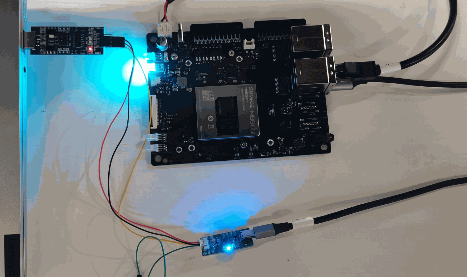

  • Connect the development board via USB to the CH348 device. Connect the CH340 test board to the Windows PC USB port and the CH348 device.
Connect CH348 RXD/TXD/GND to CH340 TXD/RXD/GND.

  • Install minicom:
sudo apt install minicom
  • On Rhino Pi A1, open the serial port with minicom.
If the connected port is UART7, run:
sudo minicom -D /dev/ttyCH9344USB7 -b 115200
  • On Windows, open the serial terminal tool and open the same port with the same baud rate, e.g. 115200.
  • Test sending and receiving messages between both ends.
Note
minicom does not display typed input by default. Press Ctrl-A Z E to enable input echo.
  • Connect the development board via USB to the CH9102 device. Connect the CH340 test board to the Windows PC USB port and the CH9102 device.
Connect CH9102 RXD/TXD/GND to CH340 TXD/RXD/GND.

  • Configure the serial port with stty:
chmod 777 /dev/ttyCH343USB0                              # grant permission
stty -F /dev/ttyCH343USB0 115200                         # set baud rate
stty -F /dev/ttyCH343USB0 -isig -icanon iexten -echo     # set other options
  • On Windows, open the serial terminal tool and open the same port with the same baud rate.
  • Test sending and receiving messages in both directions.
Send command:
echo 'demo123' > /dev/ttyCH343USB0
Receive command:
  • Connect the development board via USB to the CP2102 device. Connect the CH340 test board to the Windows PC USB port and the CP2102 device.
Connect CP2102 RXD/TXD/GND to CH340 TXD/RXD/GND.
chmod 777 /dev/ttyUSB0                              # grant permission
stty -F /dev/ttyUSB0 115200                         # set baud rate
stty -F /dev/ttyUSB0 -isig -icanon iexten -echo     # set other options
  • On Windows, open the serial terminal tool and open the corresponding port.
Make sure the baud rate matches the stty setting on Rhino Pi A1 (for example, 115200).
Use echo to send data to the serial device and verify that Windows receives it; send data from Windows and verify that Rhino Pi A1 receives it with cat.
Send command:
echo 'demo111' > /dev/ttyUSB0
Receive command:
cat /dev/ttyUSB0
