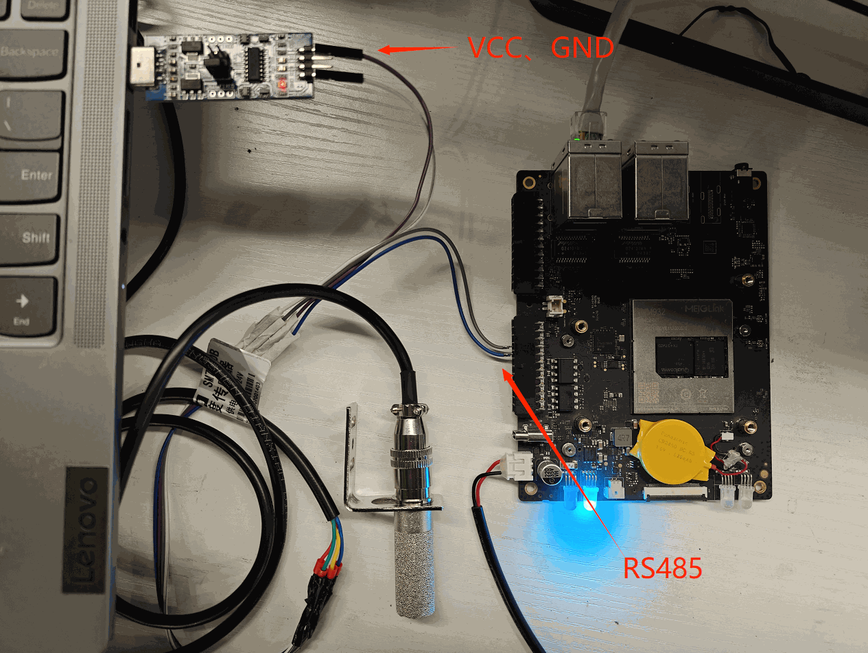

Hardware Connection
The sensor requires at least 5V power. Since the Rhino Pi A1 5V pin and GND pin are still under development, this example uses an external power supply for the sensor.
Connect the sensor RS485 A/B signals to the Rhino Pi A1 RS485 A/B interface.
