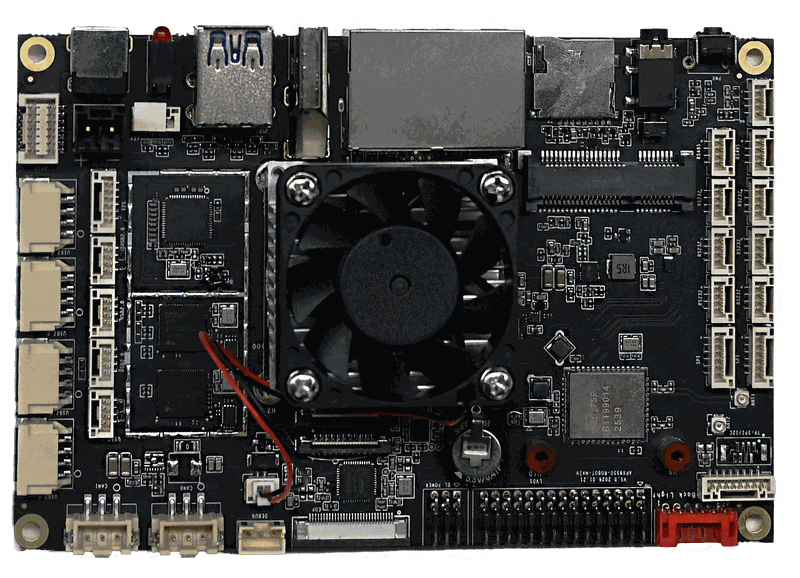

Physical Product ​
Board with fan
System Check ​
APLUX Full Image (factory default system) ​
The board comes pre-installed with APLUX Full Image (Ubuntu 22.04). After powering with a 12 V power adapter, the board will automatically start the system.
  • Power-on process: POWER LED solid red, fan begins spinning
  • System ready: STATUS LED solid green
