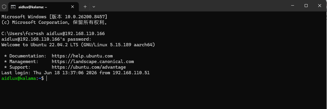

Use PowerShell, CMD, or a third-party tool (such as PuTTY, MobaXterm):
# Command-line method
ssh aidlux@<device_IP_address>
# Example
ssh aidlux@192.168.110.166
SSH remote login
On first connection, you will be prompted to confirm the host fingerprint. Type yes and press Enter. Then enter the login password aidlux when prompted to access the system.
