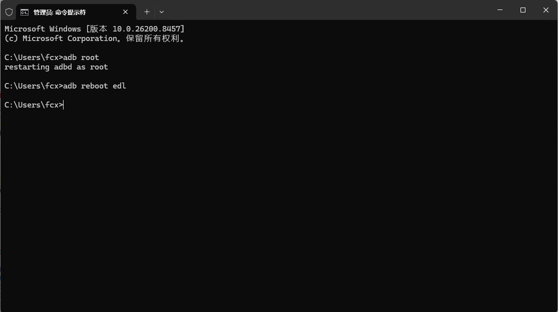

  1. Switch to flashing mode:
adb root
adb reboot edl
Enter flashing mode

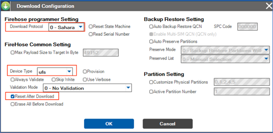

  1. Open QFIL, click Configuration → FireHose ConfigurationConfig
  2. In the Download Configuration window, set:
    • Download Protocol: select 0-Sahara
    • Device Type: select ufs
    • Check Reset After Download
    • Keep other options at default Config
  3. After configuration, click OK to save

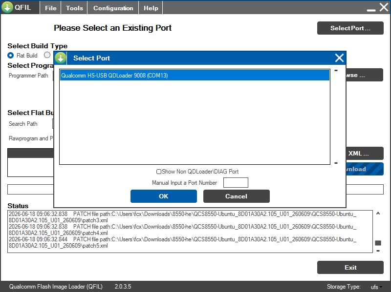

Select Flashing Port ​
  1. Click Select Port
  2. In the popup window, select the 9008 port and click OKSelect 9008 port
  3. If the 9008 port does not appear, power cycle and re-enter flashing mode

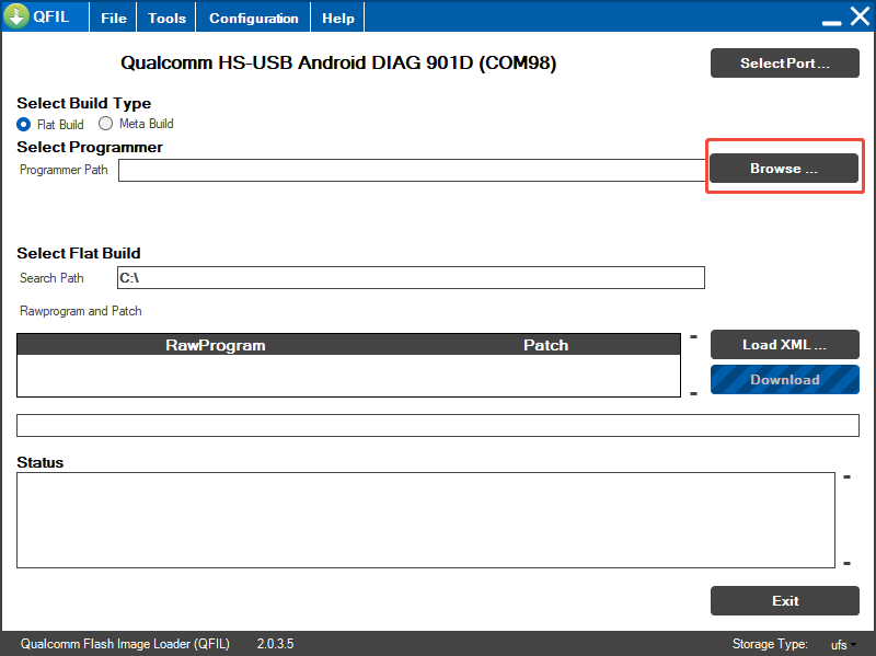

Select Flashing Files ​
  1. Extract the ROM file, find Select Build Type, and choose Flat Build.

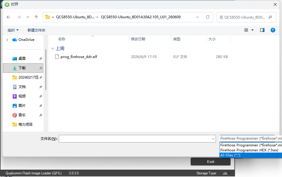

  2. Find Select Programmer, click Browse... next to Programmer PathSelect Programmer file

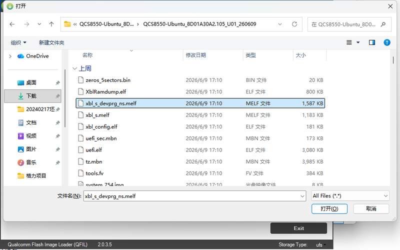

  3. Navigate to the extracted ROM file directory
  4. Change the file type filter to All Files (*.*)Switch to view all files
  5. Select xbl_s_devprg_ns.melf and click Open Select xbl file

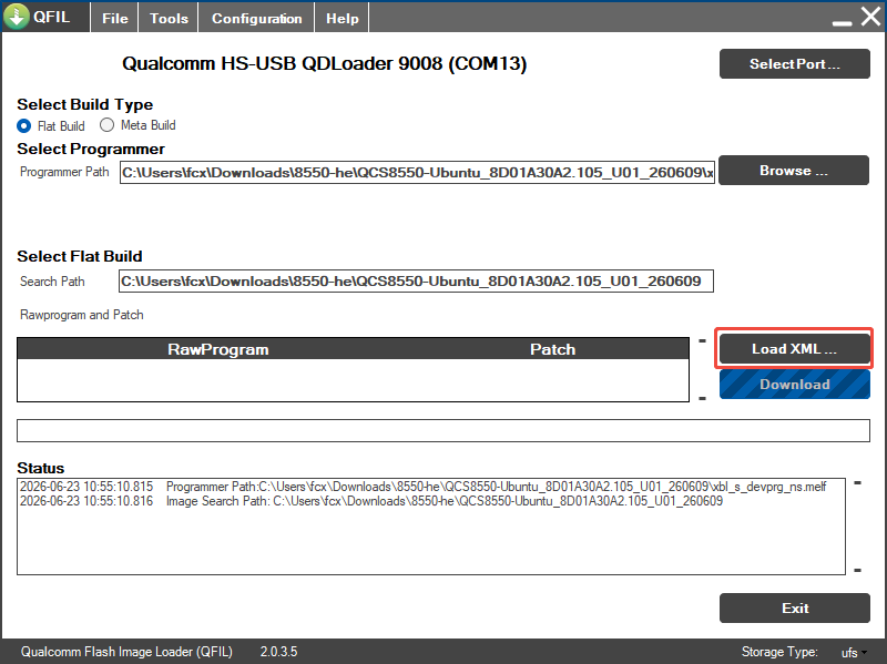

Select Flashing XML Files ​

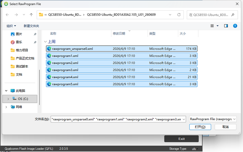

  1. Find Select Flat Build and click Load XML... below it Select Flat file
  2. In the popup window, select all XML files and click Open Select all XML files

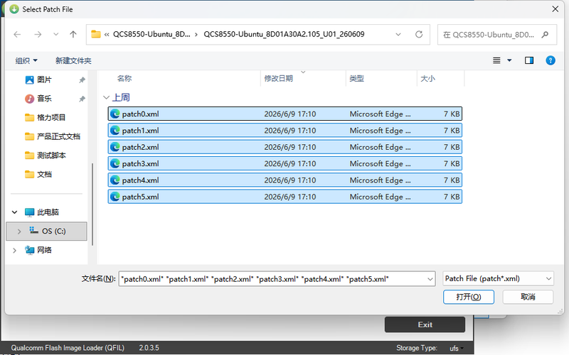

  3. Another window will automatically pop up; select all patch XML files and click Open Select all patch files

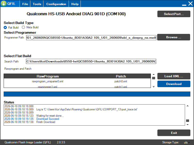

Start Flashing ​
  1. After all options are selected, click Download to start flashing
  2. Wait for the successful message indicating flashing is complete Flashing complete
