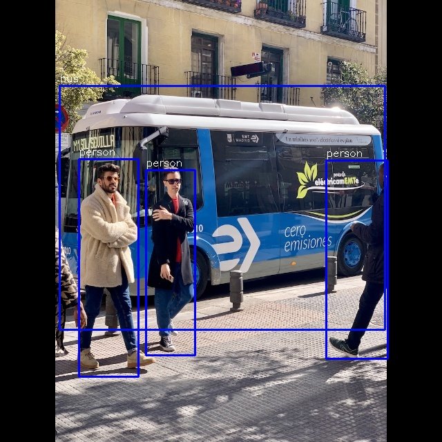

The result display file[out_yolov5_qnn_trd1.jpg] for the example is located in the current working path
The inference result box_count[4]-verify_pass_count[3].

Verification: Check the generated qnn_yolov5_multi.jpg to confirm the detection boxes are correctly positioned. Result image
