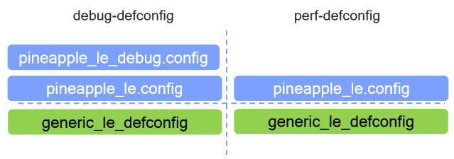

vendor 内核配置 ​
src/kernel-6.1/kernel_platform/msm-kernel/arch/arm64/configs/vendor/pineapple_GKI.config
src/kernel-6.1/kernel_platform/msm-kernel/arch/arm64/configs/vendor/pineapple_le.config
vendor 内核配置关系
